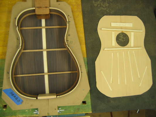

Yike, I guess I got a little picture posting crazy. Well, I'd also like to say that I seems to have better basses now. So that is really cool! I'm embarrased to post my bracing pic, but I will anyway. Like I said, I just kinda eyeballed it...

PostPosted: Sat Dec 24, 2005 3:57 am
Posts: 1059
Actually, it's an excellent first effort. Far better than mine, that's for durn sure
As for your bracing pattern, it looks very flamenco-ish. Seems that's what you might have had in mind -- namely to build a flamenco negra -- judging by the tap plates and all. But now since you have Making Master Guitars you'll have plenty of patterns to choose from on your next build.
Regarding your comments about the soundboard's stiffness, or lack of it, some of that is due to the narrow angle of the fan braces and the fact that the bottom angle braces do not extend farther toward the middle. But this is, like I mentioned, a rather flamenco-ish looking pattern. Conde Hermanos comes to mind, for some reason. Some of the flex might also be due to the top material. Cedar often needs to be left a little thicker than spruce, for example. Still, a somewhat flexible top usually does not harm the bass response, although it can make it sound somewhat thumpy. It does, however, affect the trebles. On a nylon string, trebles are improved when various techniques are used to stiffen the top on the treble side.
